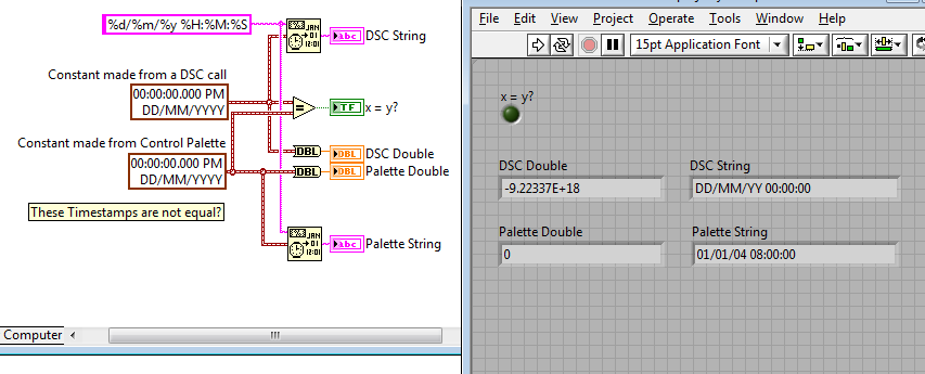

I have a returned timestamp from a DSC query using Read Alarms.vi that came back "empty"
On comparison to an "empty" timestamp (default value) taken from the Control Palette - they do not match.
Further formatting to a DBL and a string shows that the DSC timestamp is misleading and corrupt.
21958i2764063BE8084609
Additionally when you click on the Set Time and Data calender-glyph button for a default timestamp from the Control Palette you get the following:
21960i8052A984201EE2BE
Doing this from the DSC constant made into a control gives this:
21962i0260698EC314EA80
So the timestamp from the DSC seems corrupt and I can't test if its empty like I normally would.
Don't know if its the case for other VIs returned data, as haven't checked.
Is this a bug?

Thanks for the info and example VI to run! Upon running your VI I see the same behavior that you do, however, I am unable to recreate it on my own.
  1. What DSC function are you using to get the Timestamp Constant?
  2. What steps can I use to create the situation that you are showing in your VI?

I figured you were using the "Read Alarms.vi", but I wasn't able to get the funky timestamp from it, that's why I asked what DSC function you were using. I was creating constants/controls from the terminals of all the VI and wasn't having any luck, I'll see If I can get the bad timestamp by doing what you said, "Read Alarms from  Shared Variables."
Can you check the shared variable properties to ensure that timestamping is enabled for them and any other variable they may be bound to?

The funky timestamp is from a Query performed:
I registered for alarms using the User Event functions (via shared variables)
When an User Event occurred I called Read Alarms.vi and checked if any alarms in the returned query were Ack'd or not (I wanted to filter out the Ack'd alarms).
I did this by comparing the timestamp - if the alarm was not Ack'd then it has an empty timestamp - or in this case the funky one.

Yes! that does help. I am able to replicate the issue now. I will let you know what I find out by further investigating this issue.
