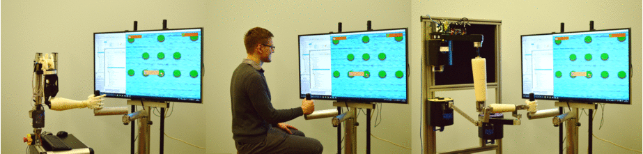

Internally Actuated Design (Prototype 1)                          Externally Actuated Design (Prototype 2)
Comparison of Prototype 1 (left), a person and Prototype 2 (right) using a rehabilitation device

ALAN-Arm Prototype 2
Due to the Internally Actuated Design (Prototype 1) limitations, we developed the second design. The Externally Actuated Design (Prototype 2) allowed us to address the accuracy, force and back-drivability requirements by using three powerful actuators to actuate the shoulder, elbow and wrist positions externally. This approach allowed to manipulate the myPAM 2.0 rehabilitation device whilst representing the shoulder, elbow and wrist positions with complex mechanical joints.
The arm is controlled by using LabVIEW, and a CompactRIO (cRIO) embedded controller. The cRIO has six NI 9505 modules, each of them powering an actuator which consists of 2 DC motors. This approach allows to have a modular design and save time due to the DC control solutions for the cRIO. Additionally, the cRIO’s onboard FPGA chip allowed us to have complex kinematics calculations done fast and reliably with determinism, which allowed to meet health and safety requirements to protect the device user. The actuator positional feedback from the system was acquired by using two analogue input (AI) modules (NI 9215) which acquire voltage readings from Bourn rotary sensors. The AI modules and the cRIO allowed to acquire sensor data with 12-bit resolution ensuring precise PID control responses of the arm. The latter has been implemented on the FPGA for added time-critical safety using NI LabVIEW SoftMotion Module, which also allowed us to implement advanced control features such as trajectory generation simply and robustly.
The kinematics use the same human arm model as Prototype 1. In this design, the human arm model is crucial, since we must ensure that the wrist, elbow and shoulder actuators do not ‘fight against’ each other, and always respect the physical linkage (upper and lower arm) between the robot end effectors. Instead of calculating four joint angles like in Prototype 1, we have to calculate six angles in total - two for each of the three robot manipulators.
Kinematics and control code was reused from both designs without modification across myRIO and cRIO platforms. Additionally, the ease of adding front panel elements meant the system could be made with huge customizability – all the PID values for each of the robots can be changed at run-time, allowing for tweaking and perfecting all parameters. Other visual aids such as 2D and 3D graphs were used to represent the arm positions on the user interface allowing to validate arm position compatibility and display the workspace for each actuator therefore significantly accelerating the prototype-testing phase.
