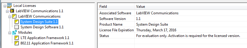

Here you can find screenshots  of MAX and the NI License Manager in case they are also useful:
Does anyone have any idea of what could be wrong in here?

I have just got I full license from NI, you can see the difference in the License Manager entries in the images I am attaching. I got this licenses from a NI employee who is helping me with my project, so I did not purchased them and therefore I did not fill and sign that sublicense agreement that you mentioned either.
Both problems (the error popping up and my unability to compile the bitfiles my myself) are still there even with these new licenses.
I will forward your comment to my contact in NI shuld he know something about it. Here is a list with updates and new actions that I am taking to try to solve this problem:
  • The same error pops up when trying to run the 802.11 App framework
  • Getting a full license for both LabView Communications and LTE App Framework has not worked
  • I am installing the LabView FPGA Module 2015 SP1
Here I attach a picture of Labview FPGA Compile Worker 2014 should it is helpful. I also attach an updated XilinxLog resulting from the failing compilation process.

I got the evaluation licenses from Xilinx, but after checking thet they are only valid for two weeks and that I was not able to compile a new .lvbitx file even with them (I might skipped some crucial step), I  got full licenses for my NI software (those that do not expire ever). Here you can see how the NI License Manager looks like now and also the compilation final message:
This seems to have solved my unability of compiling a new .lvbitx file originated from "LTE FPGA USRP RIO 40 MHz BW DL.gvi". Nevertheless, compiling the new .lvbitx has not solved the original error -63101.
At this point I have no idea how to proceed, I firmly thought that compiling a new .lvbitx file would solve the error, but it does not. My only hope is that completing the process through fpga.licensing@ni.com will solve my problem. Should you have new suggestions, they are all welcome.
