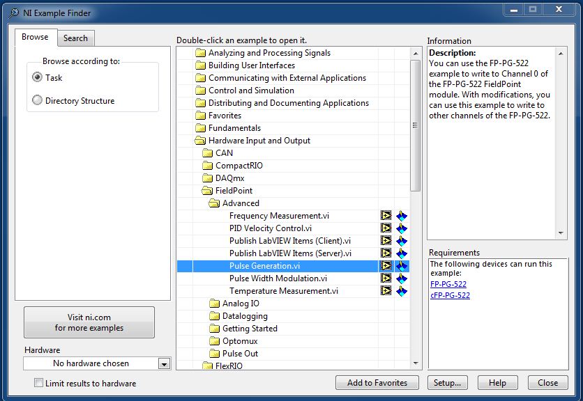

  2. Have you tested the physical output with a LabVIEW Example program?
The included LabVIEW example for your FP-PG-522 device (Pulse Generation.vi) is attached to this post. Also, it can be found by opening the NI Example Finder by clicking Help » Find Examples, then navigating to Hardware Input and Output » FieldPoint » Advanced.
