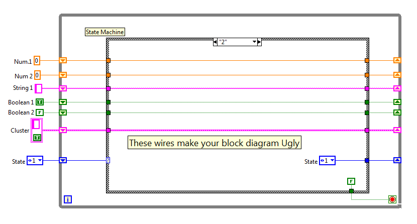

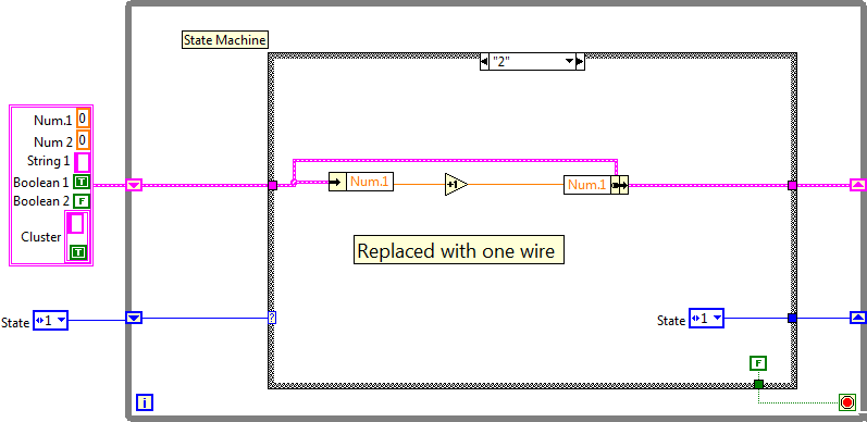

"Wrapping an Ugly VI Nugget" reminds me with something I used to do when I have a State Machine-based program with relatively high number of shift register to transfer data between different cases. So, in order to clean up your block diagram from shift registers and all the wires related to them, which may not be used in all the cases in the state machine, you can use one shift register of cluster from all the other data used in the other shift registers.
Clean up the shift registers using cluster
 Enjoy using bundle and unbundle functions with a clean block diagram.

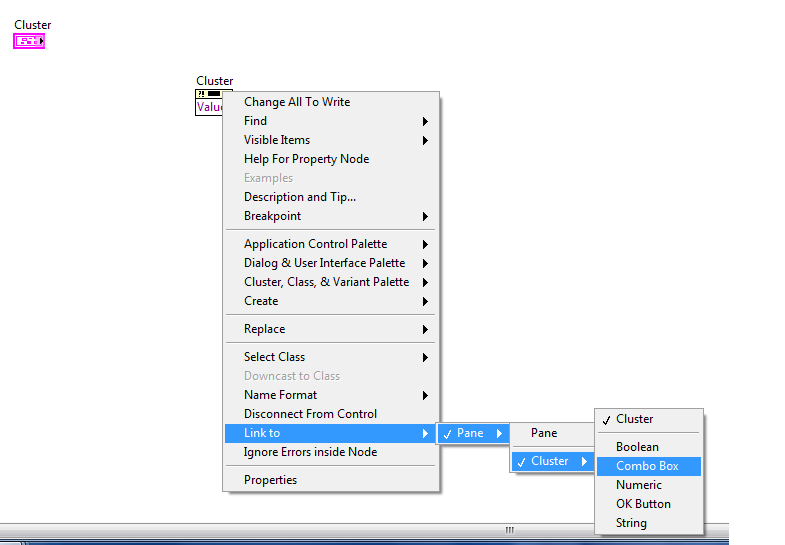

Here is a simple way to add a property node for an item inside a cluster:
create a property node, right click on the property node, select "link to" from the menu, and go through the sub menus till reach the item you wantUntitled.png
Nice trick...........
PS : you should post it also in micronugget link.
