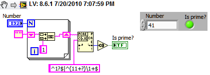

I'll begin with this one that's more of a curiosity than a useful snippet.
19455iD57361499268F06A
I saw it here (with an explanation) and had to test it in LabVIEW.  Someone is very clever.
What you can get out of this is an exercise in familiarity with the elements of Regular Expressions.
  • The pipe causes the regex to match either the expression on the left OR the one on the right
  • the carrot looks for a match at the beginning of the input string
  • the dollar sign looks for a match at the end of the input string
  • the question mark makes the preceding item optional (zero or one of whatever is before it)
  • beginning a regex with a carrot and ending it with a dollar sign only returns an exact match (in this case, either zero or one "1"s)
  • and then, the right side of the pipe...
