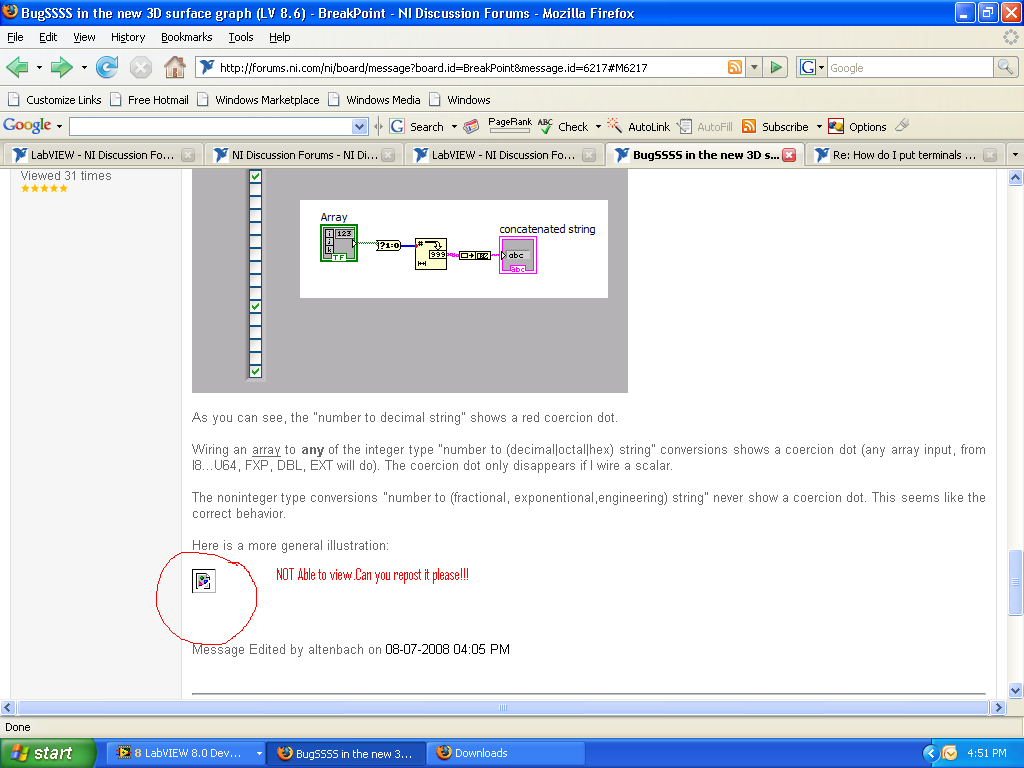

There's an apparent bug that got started with 8.5 (8.2 and earlier are OK).
Look at the picture in this thread:
As you can see, the "number to decimal string" shows a red coercion dot.
Wiring an array to any of the integer type "number to (decimal|octal|hex) string" conversions shows a coercion dot (any array input, from I8...U64, FXP, DBL, EXT will do). The coercion dot only disappears if I wire a scalar.
The noninteger type conversions "number to (fractional, exponentional,engineering) string" never show a coercion dot. This seems like the correct behavior.
Here is a more general illustration:

Hi altenbach,
                      Can you repost it? please

Thanx Mathan
So this is the image altenbach had mentioned.....
