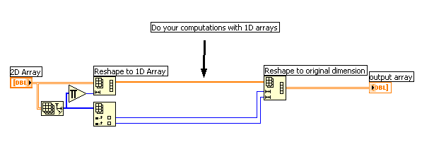

The array dimensions don't really matter for the problem.
You can reshape the 2D arrays to a 1D array for fitting, then reshape he Z' result back to the original dimension at the end. Reshaping an aray is computationally very cheap, because it just reinterprets the array without touching it in memory (see the online help on "reshape array").
After all, you simply need to operate on a collection of (x,y,z) points, it does not matter how they are arranged. The result will be the same if I uderstand your problem correctly.

Hi I missed your post about reshape 2D array into 1D array.
If I do that on Using3DPolyFitandEvaluation would that give me the correct polynomial constants? I'm having a bit of difficulty following the math here. :S

OK, here's a simple demo of what I originally had in mind (LabVIEW 6.1).
Inputs are 2D arrays for X and Y, an arbitrary odd number of coefficients (determining the poly order!) and gaussian noise.
This simulates noisy Z data (Here you would substitute your own Z data!) which is then reshaped and input into the General LS fit.
The H matrix is calculated from the X and Y arrays based on the number of coefficients.
Just run it with the default inputs for a demo.
I added some annotations, see if it makes sense to you. Good luck! 🙂
