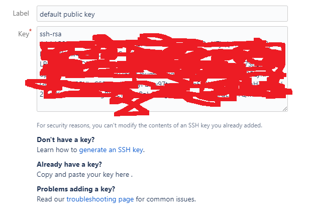

Add the public key to Bitbucket settings. If you followed the example above, this will live in "/c/Users/Fresh/.ssh/id_rsa.pub". Open that file in Notepad and copy all of the contents. Open Bitbucket in web browser. Go to your account Settings and SSH Keys (bottom left icon >> Settings >> SSH keys). Click Add key. Label your key whatever and paste the public key you copied above in the *'d box and click "Add key" in the dialog box.

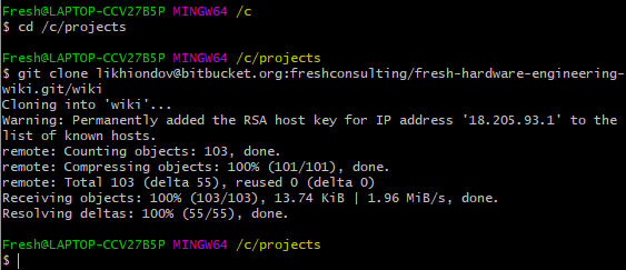

Now finally clone a private Fresh Consulting repo! Be sure to set the directory to your desired home for your clone. Example shown below, cloning this wiki.
