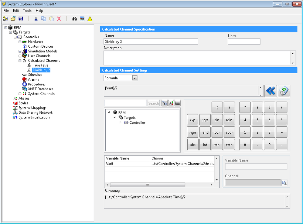

I was wondering if there is any additional mathmatical functions in the Calculated Channels Formula settings.

I'm not sure if there are any "unlisted" functions in the calculation engine, but a fairly easy way to add functions is to create a LabVIEW model and import it into VeriStand.  The basic process is create your VI, assign controls and indicators to the connector panel (mark necessary inputs as required), then under the Tools menu in LabVIEW select NI VeriStand: Generate Model from VI...  This generates an lvmodel file that you can add to VeriStand as a Simulation Model.  Your connector pane IO becomes inputs and outputs to the model.
