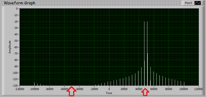

Thank you for your quick response. I tried to implement your suggestion, but came up with a problem. I attached the VI that I used, and made the parameters default values. The following is what I got when viewing the signal on a spectrum analyzer:
This was with a Root Raised Cos Filter applied to the PSK modulation. The intent was to do a BPSK modulation, upconvert it to the 49.125 KHz subcarrier, and then allow the NI USRP to again upconvert it to the final 70 MHz carrier. However, I expected the signal to be symmetric around the 70 MHz carrier. Am I doing something wrong?

The first thing I notice is that you do not use the coerced IQ rate output of the niUSRP Configure Signal VI.  Right now your requested IQ rate is 204.8k and your actual IQ rate is 204.918k.
  • You will need this because the USRP cannot support all IQ rates. Use the MT Resample Waveform function to resample the waveform just before the niUSRP Write Tx Data VI.
If you would like a second copy of your data at - 49.125 kHz then you will need to also upconvert to -49.125 kHz and add these waveforms together.
I would suggest taking an FFT of the data output from the MT Upconvert VI. If you don't have negative frequency components at baseband, I wouldn't expect to see negative frequency components at RF 😉
