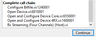

Hi all,
I have the issue, that any executable I've created for the USPR 2955 with the example file "NI-USRP Simple Streaming with USRP-2945/2955" results with the same error message "Bitfile not found."
If tried it with different configuration on different WIN10-PCs:
a) LabVIEW 2020 f1 (64-bit) + NI-USRP 20.0.1
b) LabVIEW 2019 SP1 f3 (32-bit) + NI-USRP 19.5.1
What I have made wrong? How can I make sure, that the bitfile will be included into the executable?
Thanks in advance for your support!
