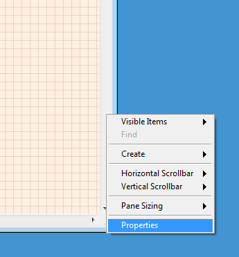

Pane Properties Menu
Right clicking on the left-hand scrollbar of a VI allows access to the Properties menu for the pane.

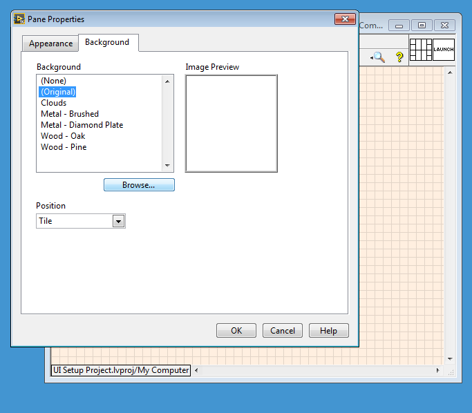

Pane Properties Dialog
From the Pane Properties screen you can browse to a background VI.

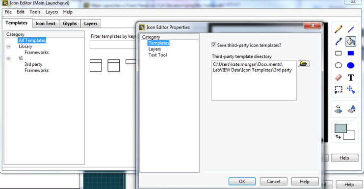

Check Template Directory
Template Directory
My templates were not reliably showing up in LV 2016, though they were great in 2015.  In the icon editor you can look at properties via the Tools menu and check your directory. My 2016 directory didn't have the same path structure as previous versions.  The referenced directory doesn't exist so I changed my path.  It still didn't show up immediately but after restart and clicking on all the sub categories they did.

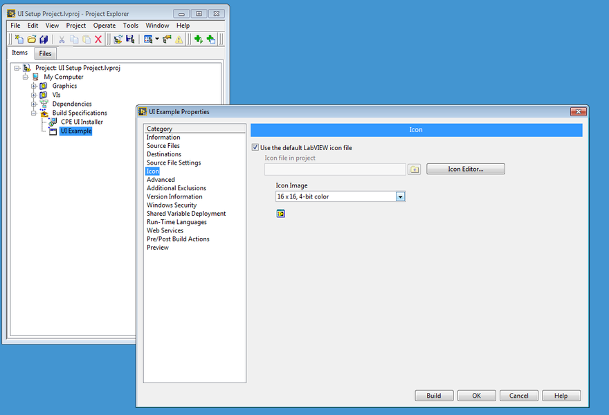

You can set the icon in the build specification under Icon.  You need to have added the icon to your project.
Set Icon
Set Icon
After Unchecking “Use the default LabVIEW icon file” you can select your icon.

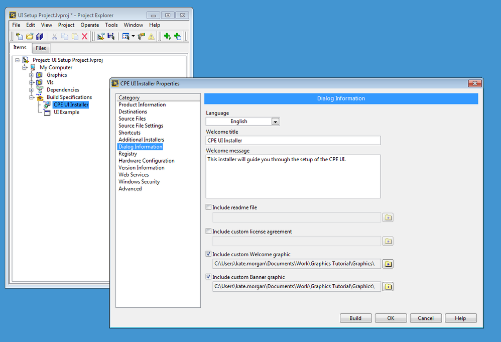

Installer Dialog Information
In the Dialog Information section of the installer you can check to include custom welcome graphic and banner graphic.  These graphics files need to be part of the project.

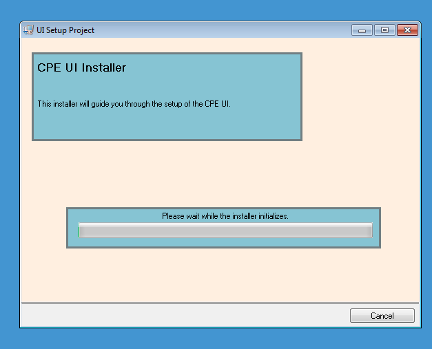

Installer Art
Example install.  The example Welcome Screen has blue boxes to show you were the text and progress bar go.
Example Installer Continuation
Install continues.  There will be text in the top area but there is room for a logo on the right.
