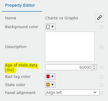

Hey Raul,
I just wanted to confirm that you are setting a value for the 'Age of stale data' property for the panel? This can be edited by not clicking on any control or indicator, and then going to the property editor. I've included a screenshot of that property below.

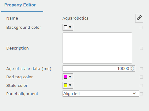

Yes I have set the age of stale data to 10 seconds (or 10 000 ms).
But if you see in the picture I posted, the cRIO for the top right corner has been off for a few hours and they show the same values as the last update.
The most confusing part is that all the outputs show that they are "stale" (Shown by the yellow ring around them) except for the text outputs (Which show nothing around them). Even when some of them should show the "bad tag" data color which I set to purple and some that are not "stale".

Here is a screenshot of the property editor
The textOutputX do not give neither bad tag color nor stale color (See original picture)
The numOutputY and the LedZ give perpetual Stale color.
None of outputs show bad tag color

@RaulPerez
This is a known issue that should be fixed in the next release of SystemLink.
@RaulPerez
The bad tag color should only display when something is wrong with the binding. A prime example of this is trying to bind to a tag that doesn't exist. I tried with 17.5 and was able to get the "Bad tag color" to appear when I tried to bind to a tag that does not exist.
What is happening in your dashboard where you expect the "Bad tag color" to appear?
