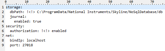

Robo 3T is a MongoDB GUI which can be used to view the data being moved about inside the MongoDB. Is it known how to connect to the System Link database (What should be the connection settings (local PC) of Robo 3T)? Now i get an 'Failed to Load list of databases' error.

Your client software needs to log in to the NoSql database. Two files should be present on your local PC after installing SystemLink Client / Skyline that contain the data you need.
C:\ProgramData\National Instruments\Skyline\NoSqlDatabase\mongodb.conf:
This contains the database connection information
And C:\ProgramData\National Instruments\Skyline\Config\NoSqlDatabase.json:
This contains the database credentials Skyline itself uses.

Thank you for your quick reply. I agree with you accessing the database directly is not adviseable. I don't want to change anything in the database i only are interesting in the architecture since the api's are not all released yet. Using your feedback i did managed to connect to the 'admin' db, Thank you for that!
Now i am logged in i would like to get the colletions information of the nitestmonitor database but i get an Failed to refresh 'Collections'  (Authorisation) error (see attached image). Do you know which credentials to use to access the 'nitestmonitor' database?
