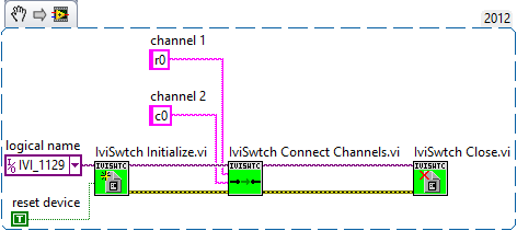

Loquito,
Have you tried verifying that your IVI configuration is working as expected? I would run/attempt to run the following code to verify that the device functions in IVI [outside of NISE]:
Do you have the error code that was thrown when you make an NISE device without the "legacy" setting? Do you have the error code that was thrown when you tried to used the "legacy" setting?

Yes, my IVI configuration works as verified in Ivi Swtch - Path Operation Test.vi. My hardware seems to check out fine when I use niSwitch Controlling a Individual Relay.vi. I just can't seem to get it to validate in NISE.
