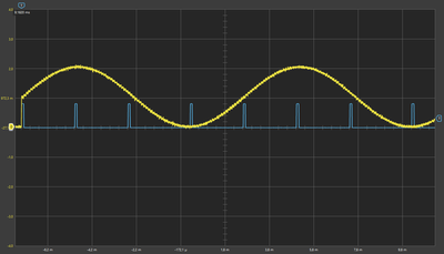

I have to generate a sine wave and populate a trigger at specific samples alongside.
I think I have to use Script Mode because I couldn't define more that one offset for the Marker in Arbitrary Wave Mode.
Using:
script myScript0
    wait until scriptTrigger0
    repeat 4
         Generate wfmSine marker0(0,24,48,76)
    end repeat
end script
I get the expected result in screenshot. Since replacing strings in the script in order to vary the marker's positions is silly I'm curious if there is a property I could set "programmatically".
