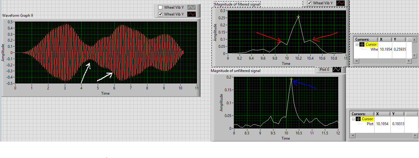

I am trying to filter the noise but when i use the butterworth filter i am not getting the same amplitude as that of the original signal(ampitude is set 1 and filtered signal amplitude is much less than0.1) it is very much reduced what should i do to get the same amplitude. Am i doing any mistake here? I have attached the VI.

My aim is to filter a sinusoid of 10 hz or close to which it occurs it is the fundamental frequency component of our system. It is the measured wheel vibration of a vehicle. After filtering the signal i take the RMS value of the signal to compare with other faulty signals. The problem is I am not able to get perfect sinusoid once i use the filter. I need a pure sine wave of single frequency.(i.e the peak which is highest near 10hz).
As you can see from the above image marked with white arrows(amplitude decreases and increases because of sinusoids with low amplitude is added) it is not sinusoid with same amplitude it keeps changing. I need the frequency of the peak marked with blue Arrow but i am also getting the peaks of red arrows which i do not want and should be attenuated so that i can get continuous amplitude sinusoid. The noises can be by various facors because it's a signal from acclerometer mounted on a running vehicle wheel. Plz help ( I had set low cut off as 9.5 hz and high cut off as 10.5 because the running frequency of the vehicle occur in this range and the order as 5) Is there some other method i can use.

I do not have much time right now.  I wil try to look at it in more detail tomorrow.
Try the Extract Single Tone Information.vi from the Signal Processing >> Waveform Measurements palette.  It uses frequency domain techniques to get data about one component of a signal.
How fast does the amplitude of the 10 Hz signal vary? How much does the actual frequency vary?
Lynn

Hi Lynn,
I thank you for suggesting the Single tone vi. I was able to detect the peak value within the range and again filter for the peak value. Now I am able extract single peak. Can you tell me why the amplitude decreases when we pass through the filter. I  did not get that part.

Bharath Kumar,
All real filters, whether implmented in hardware or software, have a gradual transition from the passband to the stopband. Typically the cutoff frequency is defined as the frequency where the attenuation is -3 dB.  For simple filters the attenuation versus frequency has a logarithmic characteristic. The attenuation curve is a straight line when plotted as decibels per octave of frequency.
For a low pass filter you can always find a frequency which is several octaves lower than the cutoff frequency. For a bandpass filter, which is essentially a lowpass filter and a highpass filter cascaded, the transition regions may overlap, especially in narrow passband filters, so that the minimum attenuation in the passband is not near zero.  A single pole Butterworth lowpass filter with a -3 dB point at 1 Hz has -1 dB attenuation at ~0.71 Hz. and about -2.2 dB at 0.9 Hz. So a bandpass filter consisting of a low pass filter at 1 Hz and a highpass filter at 0.81 Hz would have about -4.4 dB attenuation at the center frequency of 0.9 Hz.
Higher order filters have a steeper rolloff and thus less attenuation at the center of the passband. Types of filters other than Butterworth can also have much faster rolloff and are typically better choices for extremely narrowband filters.
