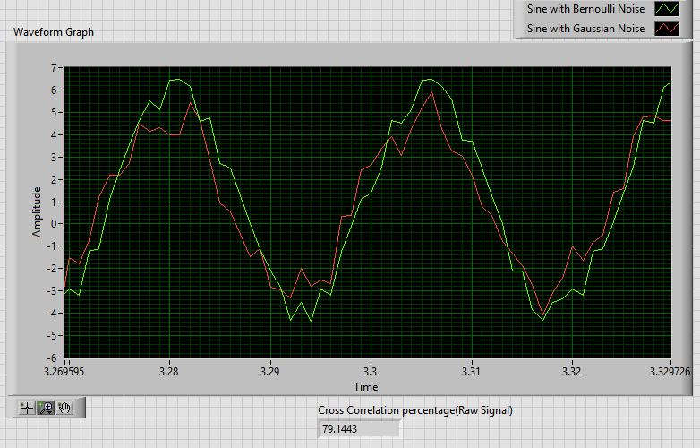

I tried giving simulated known signals as input. Two sinusoidal waves mixed with difference noise and little bit phase difference & bias voltages.
It seems it is giving the correct value for raw data.
I still have a doubt that whether this technique is correct or not?
