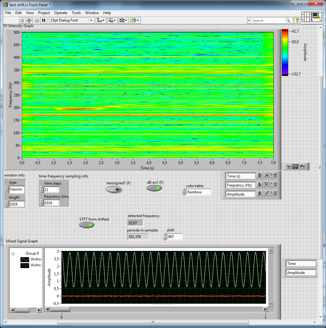

here is something to play 🙂
I shifted the signal for one periode (actually about 3 periodes to have a better samples to periodes match 😉 )  and substracted the signal.  every content in periode will be removed.
and removed the offset and applied a STFT.
have fun
and again: What information are you looking for??  Would be of great help to help you 😉

Hi Henrik,
This is working well and better than IIR bandstop filtering that i implemented. Signal is very clean.
Is sub-harmonics also getting eliminated here?
Could you please enlight me on this shifting technique that you have implemented in that VI?
What exactly is happening? What is the name of this technique? any mathematical modelling available for this?

Have a look at the vi ....    My method take the data from one (three) periode(s) and substract it from the next (three) periode(s), so ALL identical parts that equal one (three) periode(s) of the signal are canceled out. (harmonics are multiples of the base periode, so yes, they are canceld out)
However by looking at your link, I have the impression that these signals are already a measure of spindle quality because it's already tilting 😉
But I'm not in the health monitoring buisness ....
May I ask what do you know about signal processing?
BTW the main frequency is 30.07 Hz  ~ 1984 RPM
