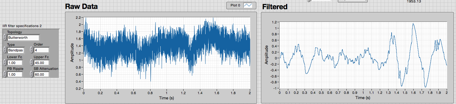

Why are you sampling at 500 kHz and then resampling to a much slower rate?  When I apply the same filter specifications to the raw data, I get the results shown below.
This was using Digital IIR Filter.vi from the Waveform Conditioning palette (LV2015). I am not sure whether the filter VIs have changed since LV 2011.
Why are you worried about a zero phase filter? The spectrum of the raw signal appears to be essentially random.

Numeric filter don't like to have a 500kHz Samplerate and a filtersetting of 1Hz to 45Hz.
Think of a 1Hz sine sampled at 500kHz and a 4th order filter. the coefficients will scrap at the lower end of the numerical resolution ....  add noise and the filter is quickly lost 😄
Decimate (with filter) to 500Hz samplrate and try again 😉
Another way to compensate the filter phase of  finite samples is  to filter twice with reversed data.
data -> filter -> reverse data -> filter - reverse data
