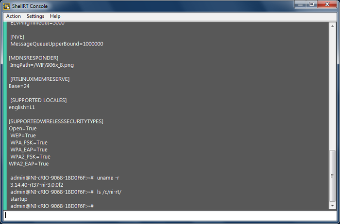

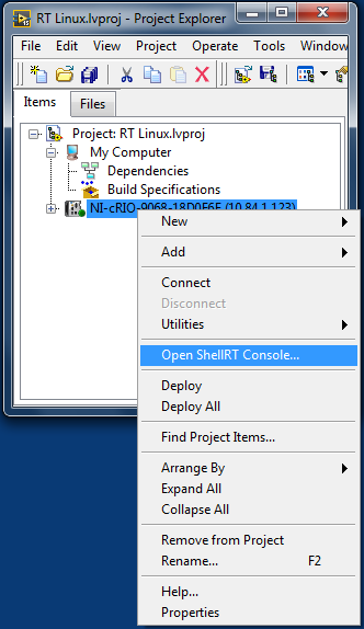

ShellRT is a small add-on that allows quick access to a remote console window of a Linux Real-Time target from the LabVIEW project explorer. Developers can interact with a selected target without leaving the LabVIEW environment, thus improving the overall development experience using the Linux Real-Time hardware platform.
This utility provides quick access to a remote console to improve the development experience with our LinuxRT Real-Time targets.
Features
  1. Open a remote shell from the LabVIEW project window
  2. Facilitates interactions with NI Linux Real-Time targets by executing supported Linux commands
  3. Ideal for intermediate or advanced developers
  4. Offers a logging mode to debug onboard behaviors.
  5. Allows multiple shell consoles to be used in parallel to execute independent tasks (2.0 and later)
  6. Allows path autocompletion pressing the Tab key when typing a command (2.0 and later)

Nice tool. A few suggestions:
1) allow multiple open shells from different targets simultaneously. Right now you can only have multiple shells from the same target.
2) Add the name of the target to the top of the shell window so once (1) is in place you'll know where you are. The command prompt does tell you but...
3) need basic text document editing. Right now "vi a.out" produces something unusable...
