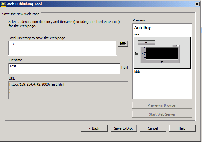

I am trying to make a remote panel to control my cRIO. I do with the instruction from this link
http://digital.ni.com/public.nsf/allkb/AB6C6841486E84EA862576C8005A0C26
But after doing as following steps, it failed to load the VI on the web server
Step1:Open the VI which will be the front panel and using web publishing tool...
Step 2: after enter Title, choose the directory to save the web page
Step 3: After saving, it is included in my project under RT-target
Step4: I deploy all and then create the RT application4.png
Step 5: Deploy it and run as startup. Then I restart the cRIO.
Step 6: After restarting, I try to connect the cRIO again to check whether the VI started or not. It shows that
Step 7: Open it in web browser:
It does not show the Start-up VI.
I have installed the Runtime Engine 2015 already
Please help me. coz this is the first time I work with cRIO

After check again with the newest IE, It shows me that "Server does not support Remote Panels". Please give me the solution

2/ at first I think as you mentioned. HMI should be in the host. but when I create the Real-time application from BUild specification. I can not add HMI as the startup VI ( as the following picture). I dont understand the meaning of "Startup VIs". It means the UI appearing on web server or the VI will run automatically when cRIO starts?

Firstly, thank you for your guide. It's very clearly and useful
Then, I have two problems here:
1/ The VI I chose has the path quite strange with "EDIT_cRIO9xxxx_{ABCXDDDDD....}"
2/ I cannot preview in Browser 😞 that could be the reason why it shows "Server does not support Remote Panel"
As the last time I checked the software in cRIO. I have installed all software into it. But I will check it again next week, coz now is the weekend so I am not in the lab of my uni.
Hope you can see my problem and help me. thank you so much again
