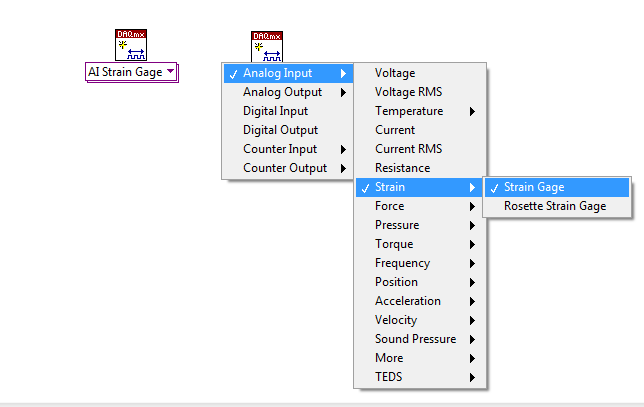

I should review some basics then. What do you mean by "You could also change the DAQmx Create Virtual Channel (VI) in the code to “AI Strain Gage”
Erden
j_bou
NI Employee (retired)
Re: Configuring Virtual Channels for LabVIEW Real-Time Waveform Acquisition and Logging (NI-DAQmx) Sample program
Message contains an image
Hell ErdenV2,
Below is a picture describing what I mean. You can change the polymorphic instance of the DAQmx Create Virtual Channel.vi to a AI Strain Gage.
J_Bou

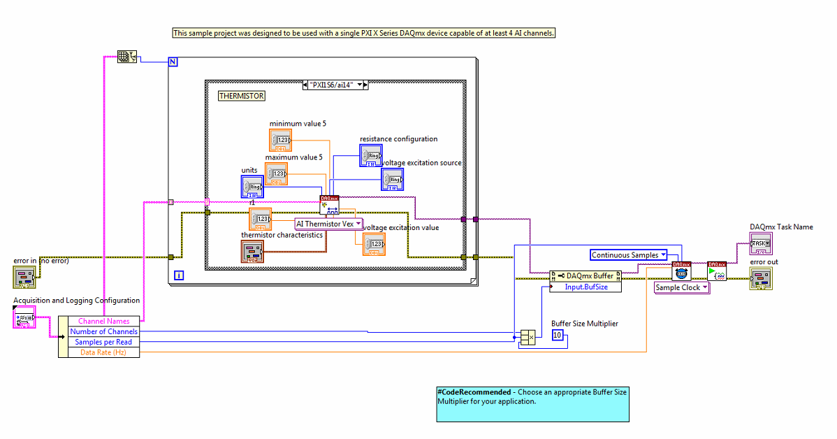

I changed the program and added a case structure to configure each channel according their type. In order to go through all the channels in the configuration file, I put a for structure.
It seems it is working, however, when I start acquisition, I only see one channel and that is last one which is configure.
Here is the original file, configures all, but only works for AI Voltage:
Here is the modified one:
What I am doing wrong?
Thanks!
BriBear
Member
Hi ErdenV2,
The reason why you are only seeing the last DAQmx task configured is that the for loop tunnel for the task is set for tunnel mode "Last Value." If you right click the tunnel and select "Indexing" mode you will create a task for each channel. However, to successfully configure and start each task, you will need to set the DAQmx Timing vi and DAQmx Start Task vi for each task.
