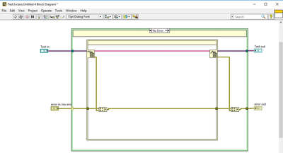

This QDK creates a method with DVR input and output, similar to the Static Dispatch VI method for a class, adds it to the Owning class and places an in-place element structure to read the class object out of the DVR. I think, a similar option is available in LV GOOP, not in LVOOP. This might be useful for devs who create DVRs of the class object after instantiation and pass the DVR throughout instead of the object itself.

Click on a Class Object constant / control / indicator
Use Ctrl + Space; Ctrl + Y to invoke this QDK
