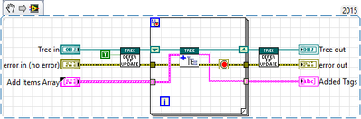

There is a dependency to the TreeSelection class in the the TreeControl class, it is caused by the method "Add Items" which has an object reference to the TreeSelection class (instead of the TreeControl class). The method "Add Items to End" in the TreeControl class is also stored in the wrong folder (it's currently in the TreeSelection class folder).

There is a problem with the method "Add Items", but maybe it is supposed to be part of the TreeSelection class (but I guess there should be a method "Add Items" in the TreeControl class as well)?
As it is now, the class TreeDirectory, which inherits TreeControl, can't call this method (which should be possible).

Okay, you are right.  I am seeing something weird there.  I was confused because the Add Item.vi was correct but the Add Items.vi (with plural items) is wrong.
The class input/output is TreeSelection when it should be TreeControl.  It looks like I never finished the VI properly because the other inputs and outputs and errors weren't connected to the connector pane.  I will fix this for the next release.
I am currently finishing updates to the documentation and then all fixes to this point will be submitted to the Tools network.
FYI. Here is the fixed VI (also attached).
