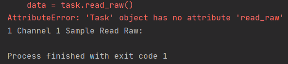

I would like to acquire raw data from ADC. the python example in https://github.com/ni/nidaqmx-python/blob/master/nidaqmx_examples/ai_raw.py
failed with following message.
Does anyone how to read raw data of ADC
