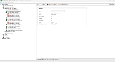

MAX Double Enumeration:
Every module shows two instances in NI MAX.
One shows with red X and supports Self-Test (but fails); the other has no self-test option.
Removing/reinserting/rebooting does not fix the double-enumeration issue.

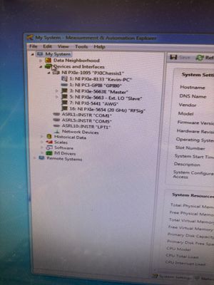

Same PXIe system works perfectly when using PXIe‑8133 as embedded controller
In that setup: only single device enumeration in MAX, and all LabVIEW sessions initialize properly

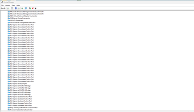

In Device Manager I can only see a generic PCI-to-PCI Bridge entry under System Devices. I don’t see any device explicitly named NI PCIe-8371, and in NI MAX there is no Self-Test option for the 8371.
Is this normal? From my understanding the PXIe-8370 (chassis side) will not appear in Device Manager, but the PCIe-8371 (host card) should normally be listed with the NI name. If it only shows up as a PCI Bridge, does that mean the NI driver isn’t loading, or could it also indicate a BIOS resource allocation problem?

The 8370 + 8371 is mostly system devices. They will show up as a bunch of bridges or switch ports (the latter in your case) plus one "NI SMBus Controller". Chassis/backplanes will also have bridges or switch ports. The subsystem IDs of the switch ports will typically have NI IDs (subsystem vendor ID = 0x1093), but they're inherently system devices so they get generic drivers from the OS instead of NI drivers.
What you're seeing, where there are a bunch of PXI boards in device manager, means that the MXI kit is working at a HW level. Typically that means the system will work.
I'd certainly try the BIOS Compatibility SW. It works with 2 types of MXI boards. One type uses the utility to enable/disable the compatibility mode, the other uses a physical DIP switch on the PCIe card. The PCIe-8371 has a DIP switch. If you set the top switch without the SW installed you won't see much in Device Manager (1 or 2 switch ports), and when the SW is installed device manager should look the same as what you're seeing (but the enumeration will have been done differently). Note that NI MAX may think the boards are different because of the difference in enumeration.
