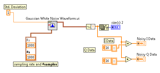

Does anyone know how to add AWGN to a carrier generated using NI RFSG ?
I know how to generate a CW signal using NI RFSG in Arbitrary Waveform mode (please see the attached file),  but I have not found out yet how to add AWGN to it.

Well, I  examined the "RFSG Arbirtrary Waveform Generation.vi" file.  Actually, it generates an arbitrary waveform through the RFSG.
However, it's very similar to the program I attached to my original post, in which I set I=1 and Q=0 to generate a sine wave. I data and Q  data are declared as data arrays.
What I want to do is to add a SNR-controlled noise (AWGN) to the generated sine wave.

Aina,
I think you can just use one of the AWGN functions in LabVIEW and simply do a point-by-point add to your I/Q arrays.
Let me know what you think. Thanks, Aina.

Hello Robert !
Thank you for the tip ! It works great.
However, by doing a point-to-point add to the IQ arrays, the generated signal becomes  [I(t)+N(t)]*sin(2*pi*f_carrier*t) + [Q(t)+N(t)]*cos(2*pi*f_carrier*t)
instead of I(t)*sin(2*pi*f_carrier*t) + Q(t)*cos(2*pi*f_carrier*t) + N(t) where N(t) represents the added noise.
Any idea how to generate a  I(t)*sin(2*pi*f_carrier*t) + Q(t)*cos(2*pi*f_carrier*t) + N(t)  signal using NI RFSG in Arbitrary Waveform mode ?

Hi Aina,
Do you have Modulation Toolkit? If you do, there is a VI that will do exactly this called MT Add AWGN VI. If you don't have Modulation Toolkit, we can discuss this further if need be.

Hi Robert !
Yes, I do have Modulation Toolkit. I actually know the MT Add AWGN VI.
But I guess that the way we generate the carrier from NI-RFSG  is different from what we discussed previously.
Do you know any good example to start with ?

Hi Aina,
I may still be not completely understanding exactly what you're asking for. So in my example that I gave you, we were adding the AWGN to both the I and Q arrays seperately. What you're looking for is to actually add the noise to the signal after it has been upconverted. Does that sound right? With our hardware, this is not possible because the baseband I/Q data is mixed with the carrier in hardware as the last step before it is generated. To add AWGN after the signal has been placed on the carrier you would need a noise generator. The best you can do is to add the AWGN to the baseband I/Q and then upconvert it based on the carrier frequency you specify in RFSG. Let me know if that was helpful to you.

Hi Robert !
Exactly, I want to add the noise to the signal after it has been upconverted. But I guess it won't be possible with the RFSG then.
I will try different forms of the noise added to the I and Q arrays to see i if I can get the output noise that I really want.
