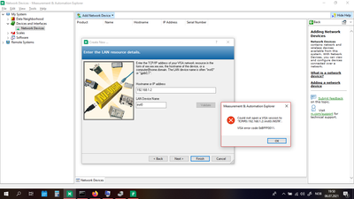

I have also tried manually adding the PXIe-8820 in MAX (since it does not show up automatically) by using My system > Devices and Interfaces > Network Devices > Add Network Device > VISA TCP/IP Resource… (trying the “Find Network DAQ Device” just returns the error “Unable to launch dialog. Please confirm the driver software is installed correctly and that configuration support is included.”) > Manual Entry of LAN Instrument (the “Auto-detect of LAN Instrument” cannot, for some reason, find any VXI-11 LAN/LXI instruments on the local subnet). Everything good so far, however, when typing in the PXIe-8820’s manually set IP address, 192.168.1.2, and the LAN Device Name, “inst0” (would this be the right name?), I get the VISA error code 0xBFFF0011. See the screenshot below for visual information.

In my experience, you cannot add a windows controller as a remote system to NI MAX (other please feel free to correct me).
In all my PXI experience so far, we directly remote into the embedded controller running windows and do everything there, and no need to have an ethernet-based control of the PXI system.
If you are limited by Win10 education system, you can install TeamViewer or VNC on the embedded controller and laptop and work around the limitation of Windows Remote Desktop feature.

Hi Santhosh,
I see. Well, I suppose that could explain why I have not been able to detect anything. Thank you for the help!
