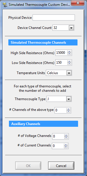

Overview
This custom device allows the user to configure any standard +/-10V analog outputs to behave as a simulated Thermocouple.  This is done by inserting a 2 resistor voltage divider on the output of each channel.  Sources of error are calibrated out through the use of a separate temperature measuring device that acts as feedback to the custom device.  Any combination of J, K ,T, E , N , B, R and S type thermocouples are supported, and unused channels may be configured for voltage (or current) output as required.
Requirements
Hardware:
Any +/-10V Analog Output channel that uses the NI DAQmx Driver can be used with this custom device.  This includes M and X series Multifunction DAQ devices provided that have Analog Outputs, provided the Ananlog Outputs are not also configured as DAQ channels in the DAQ section of the System Explorer.  The ideal device for higher channel counts is a dedicated Analog Output board in the 67xx family.  The PCI/PXI-6704 is the only board that supports current outputs.
Software:
NI Veristand 2011 (Source code can be compiled for previous versions)
Instructions for Use
When initializing a new custom device, you will be prompted to enter the physical device ID, general settings, and the number of channels to create.  After pressing OK, the channels will be initialized.  You can add additional channels later by right clicking the custom device and selecting Add Channels or by pressing the Add Channels button on the task bar.  Individual channels and sections can be configured as required via their corresponding pages.  The value applied to each thermocouple channel is the temperature that you would like the Device under Test to see, were a real thermocouple attached.
