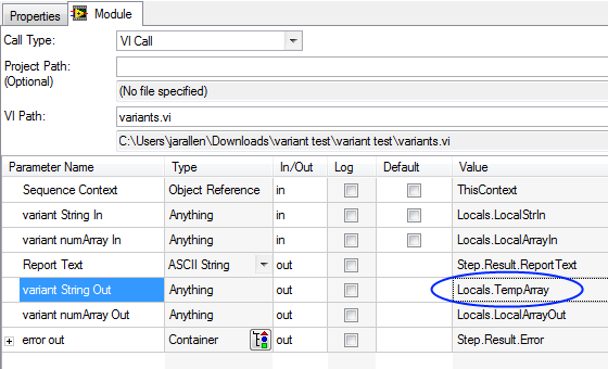

Kevin,
Here is the process I used to convert the LabVIEW Variant (holding a string) into a TestStand string.
1. Create a new Variable in TestStand of type: Array of Number. Name this TempArray.
2. Make the size of TempArray 256 (or whatever maximum size you expect the string to be).
3. Change the Numeric Representation of TempArray to U64.
4. Set the output of the code module to our newly created TempArray.
5. Add a Post-Expression to the step that converts TempArray into a string and stores it in LocalStrOut. The expression used is: Locals.LocalStrOut = Str(Locals.TempArray, "%c")
Jared A.
