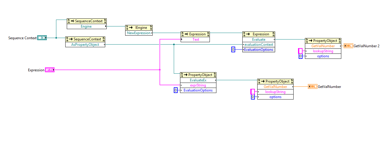

I am looking for an example of using "EvaluateEX" TS API method in LabVIEW.
I would like to get back the return value of the expression evaluation. Any example will be welcome.

Hi Jean-Louis,
Try this example.
The sequence has an ActiveX API call and a LabVIEW 6.1 NumericLimit step type call.

Just in case you don't want to download and open VI's.  Here is a screenshot that shows 2 different ways to do this...
