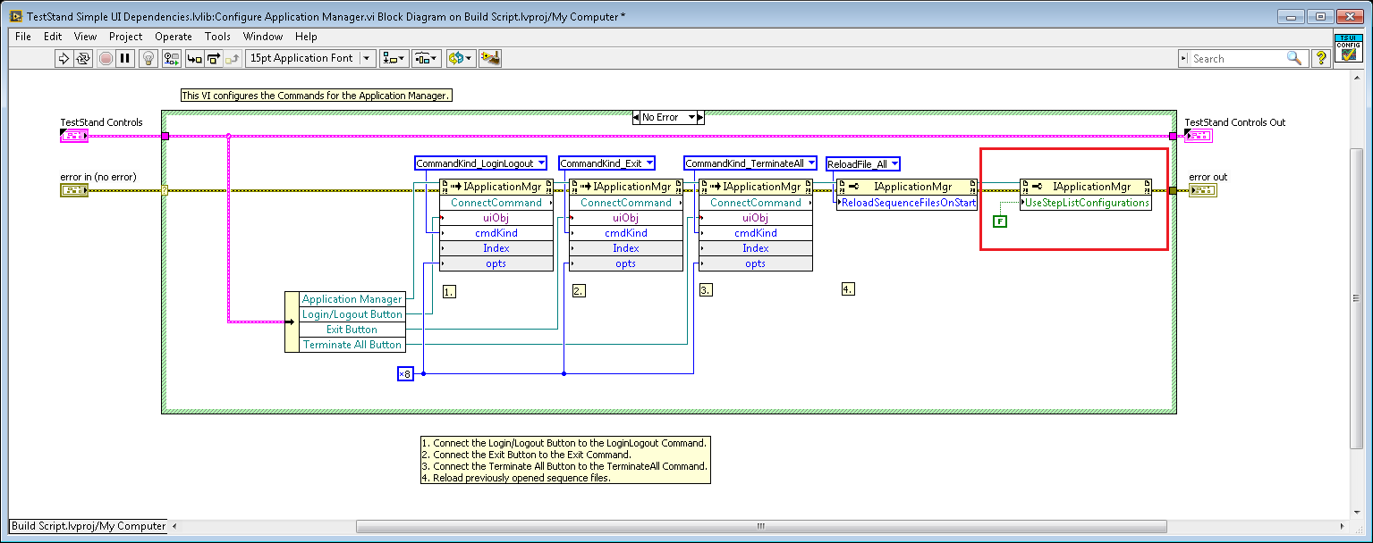

Thanks for the repsonse, here are some screen shots which step through what needs to be done to replicate this issue:
  1. Right Click on the Execution View Control --> SequenceView --> Properties
  2. Navigate to the Columns tab, ADD a new column and set its type to "Status" and set the name and caption to whatever you like (I called mine "Foo")
  3. Click OK and see the following popup informing that changes to the default control need to have a property set to FALSE
  4. Add a property node to the "Configure Application Manager.vi" as highlighted and set it to FALSE
  5. Load a sequence file and run it (I ran it as 'Single Pass') and then notice the background color is absent from the Status-type column

Hi SeanDonner,
Here are some properties that might be helpful to you, specifically around the SequenceView object.
I think this might be the property that you're looking for
Setting the Background Color:
ItemBackColorExpression Property
https://www.ni.com/docs/en-US/bundle/teststand-api-reference/page/tsuiref/sequenceview-itembackcolor...
Here is another that also might be helpful, as well as a list of all other properties that you can set in the SequenceView object
Setting the Text Color:
ItemTextColorExpression Property
https://www.ni.com/docs/en-US/bundle/teststand-api-reference/page/tsuiref/sequenceview-itemtextcolor...
The higher-level list of properties for SequenceView:
https://www.ni.com/docs/en-US/bundle/teststand-api-reference/page/tsuiref/sequenceview.html

Perfect!
Here is the equation I used for the Status column to achieve the default dehavior in case others have this issue:
Step.Result.Status == "Failed" ? tsRed :
    Step.Result.Status == "Passed" ? tsGreen :
        Step.Result.Status == "Skipped" ? tsGray :
            Step.Result.Status == "Done" ? tsCyan : tsDefaultColor
Let me know if I missed a possible Status value and what its associated color should be.
Thanks!

Can somebody explain why the color stopped showing up? I, too, have that situation where a test station used to show colors but has stopped, even though I have not changed anything.
Message 8 of 9
(5,328 Views)
Hi rdecarree11,
When you set ApplicationMgr.UseStepListConfigurations to false you are removing the file that sets the colors (UserInterface.XML). The Step List Configuration sets "various options that determine fonts, colors, visible columns, and other aspects of the Steps pane." The options for editing Step List Configurations seems more intuitive in the development environment than in the LabVIEW UI. However, you can build your own Step List Configuration in the LabVIEW UI as users were doing above.
The UserInterface.xml file stores the multiple configurations for Viewing Files and Viewing Executions. You can find where the TestStand Step List Configurations are stored using the article linked below.
"Where are my TestStand Step List Configurations Stored?" -
https://knowledge.ni.com/KnowledgeArticleDetails?id=kA00Z000000kHNESA2&l=en-US
