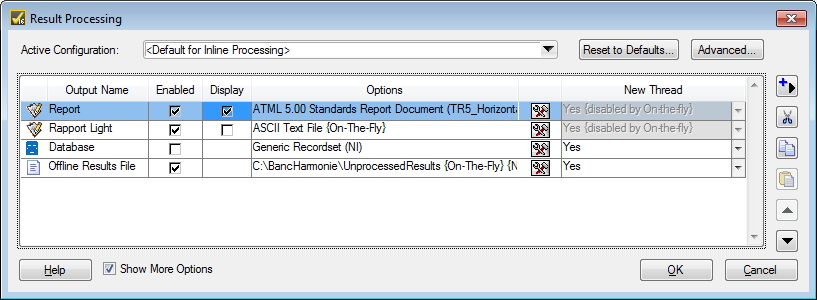

after executing a testplan normal to the end it creates an xml-file but does not show result in Teststand. Only grey window appears.
While executing i see the red/green trace results but at the end nothing.
How can i enable to see the results?

If you are running a recent version of TestStand, i.e. 2012 or beyond I guess, check the Result Processing configuration (menu Configure » Result Processing..). There is a checkbox to indicate Display. Is one of your result plugins configured with this checkbox ? (below the first one, Report, in ATML 5.00 format).
