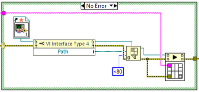

Going that deep into workarounds, I have implemented something similar as a workaround which does actually work.
Asynchronously spawned VIs which are still running do not get dumped. And if this VI keeps the reference, neither does the ref. (Edit: Important to note these VIs do run in the LV Development System App. I don't know if the behavior is the same when everything runs in the LV Runtime inside TestStand)
It is a few layers which makes it kind of ugly but it works.
Regular VI which gets called normally in TestStand:

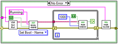

Asynchronously spawned "keep alive" VI:
As long as the loop loops, the reference (in our case a DVR inside the LV object) is alive.
