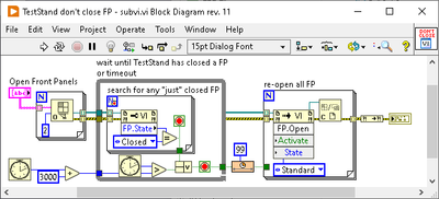

Here is a Workaround 🙂
Part 1: Put this into 'Cleanup' of all your sequences and add a precondition:
RunState.CallStackDepth == 0
Part 2: SubVI will do the "re-open".
The small delay is needed to wait until TestStand has finished closing windows.
Thank You for Kudos.

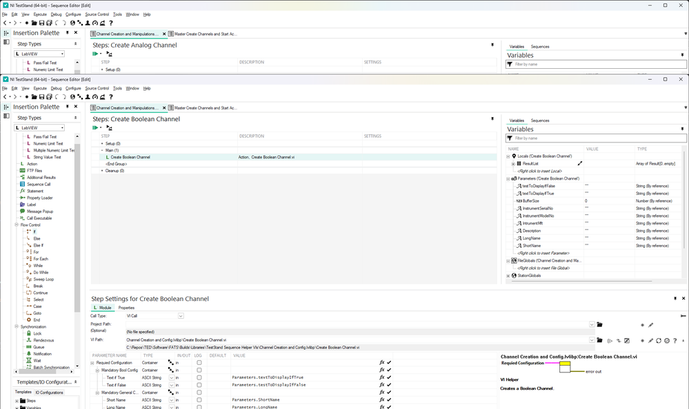

I'm seeing something similar and am at a loss.  Figured I'd post here, as I think it's the same topic.
I have a LabVIEW application that I'm embedding TestStand into.  I use TestStand to run test sequences and configure the test benches.
One such sequence creates channels that make LabVIEW calls to a singleton pattern method from a packed library.

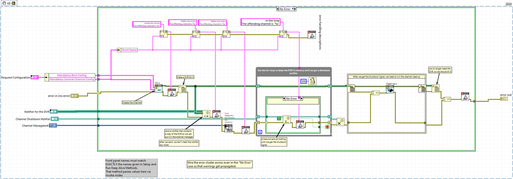

The create channel singleton looks like:
Everything runs just fine as long as the sequence is running.  I can put a while loop at the end, and let it loop and it's great.  But if I don't force the sequence to keep running, and allow it to finish execution, it appears the notifier I use as a shutdown notifier gets nuked (see comment "5" in the block diagram above).
 The keep-alive that I run as-sych:
I get this error, when apparently the notifier I create in the first block diagram gets nuked and the "wait on notification" in the 2nd block diagram see's the reference is now invalid.
Again, these are singleton calls from within packed libraries.
How do I keep this from happening?  How do I keep TestStand from Nuking my notifier and data structures running from w/in the larger application?   Anyone seen anything similar?
