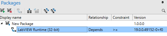

Does anyone understand clearly how dependencies are working for pacakges. It's unclear for me inside NI Package Builder and it's the same inside LabVIEW.
How can I configure the package to requests for example to request TestStand Version 2019 but without taking in count the patch installed?
It can be the same for any package that can have patch. For example LabVIEW Runtime. I need absolutely the LV RunTime 2018 but I don't care if it's the 2018 F1, F2, SP1 f3 for example. Is it possible to configure it like that ?

Maxime -
NIPB:
In NIPB after you add a dependency to an installed package, the default relationship is >= the version of the installed package.
 If you select the dependency as shown above, the Properties pane looks like shown below. In your case the 3rd digit is non-zero, i.e. "19.0.1"...
You can change the Version Type to Custom, and edit the version to be "19.0.0.0" as shown below:

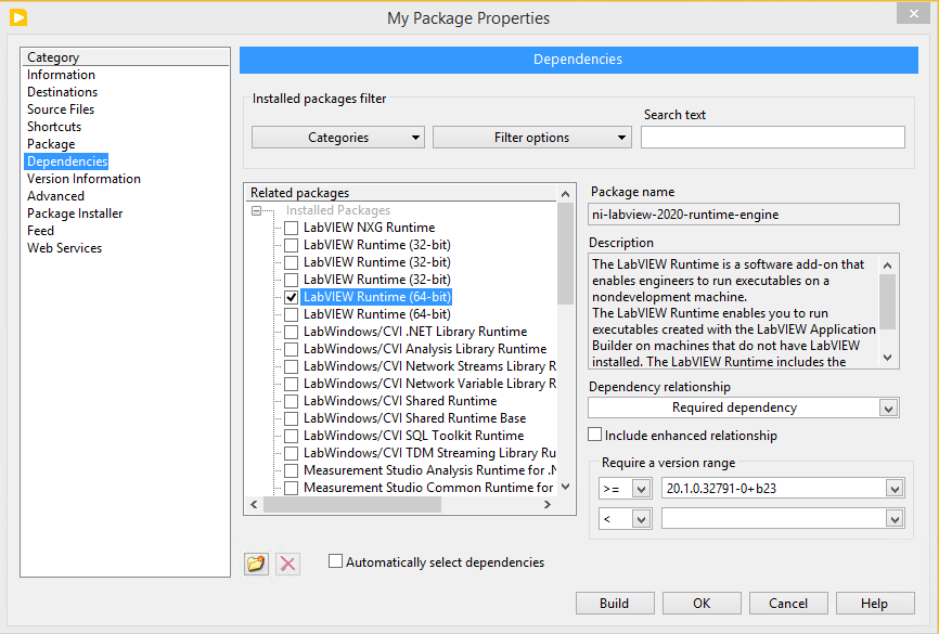

LabVIEW:
You must first unselect "Automatically select dependencies". Then to enable the controls on a package click on a different package and then back to the package to enable the "dependency relationship" controls. Then change the >= version accordingly as shown below so something like "20.1.0.0"

MaximeR, NI Package Builder support specifying a range for a dependency by adding the dependency twice and editing the constraint and version value, e.g. as shown below:
And this will build the control file list this in the control file:
Depends: ni-package-builder (>=20.5), ni-package-builder (<<20.6)
If you build an installer or feed, Package Builder will attempt to include a package that satisfies that dependency and if previously installed and in the cache or currently installed, it will fail to build.
Setting a version to equal (=) is very restrictive and should only be used if really necessary.
