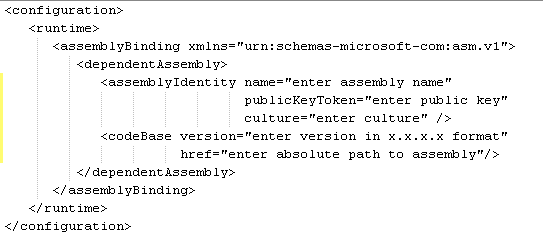

Macie,
Thanks for providing the error call stack. This helped us understand the problem such that we could investigate it further and provide a solution for you. Here's the reason you're receiving this error.
TestStand's .NET Adapter uses the Assembly.LoadFrom() method to load the specified .NET assembly into memory. The LoadFrom() method provides the useful feature of searching for any dependencies of the specified assembly within the same directory. This allows TestStand to load assemblies and their dependencies from locations other than the Global Assembly Cache (GAC) or the Application Directory (<TestStand>\Bin). When TestStand calls the LoadFrom() method on the specified assembly and it's dependencies, the assembly and dependencies are loaded into memory in the LoadFrom Context.
When you attempt to deserialize types in your code, the CLR will look to the Load Context for the assembly that contains the type that is deserialized. Because the Load Context is a different context than the LoadFrom Context, the CLR does not recognize that the assembly is already loaded into memory and it tries to load it using the Assembly.Load() method. The Load() method only searches for assemblies in the GAC and the Application Directory. Thus, calling the Load() method on the assembly that contains the type that is deserialized will fail if your assemblies are not located in the GAC or Application Directory and you will receive the error that you're seeing.
There are a couple of solutions to this behavior:
1. You can create an Application Configuration file that uses the Codebase element to point to the location of the necessary assemblies on disk and place the config file (SeqEdit.exe.config) in the Application Directory (<TestStand>\Bin). This would require that you provide a <codeBase> element with the absolute path of the assembly for every assembly that contains types that are deserialized. This approach has a couple of downsides:
  • It requires that you hard-code the absolute path of the assemblies that contain types that are deserialized, such that you would have to remember to update the config file anytime the path to your assemblies changes.
  • It requires that you place a file (the config file) in the <TestStand>\Bin directory and more importantly the Program Files directory (a protected directory).
The SeqEdit.exe.config file would look similar to the image below:
2. You can create your own .NET assembly to provide an AssemblyResolve event handler that returns the assembly already loaded in the LoadFrom Context when deserialize is called. This assembly would have to be called at the beginning of your sequence for each of your assemblies that contain types that are deserialized. This is the approach that I would recommend.

  • The SeqEdit.exe.config file is an example Application Configuration file that displays the use of the <codeBase> element. This is solution 1. You can place this file in the <TestStand>\Bin directory, then update the assembly path to what it is on your computer. Once you've completed this, you can skip the ResolveAssembly step of "test sequence.seq" and you'll notice that you do not receive the error.
