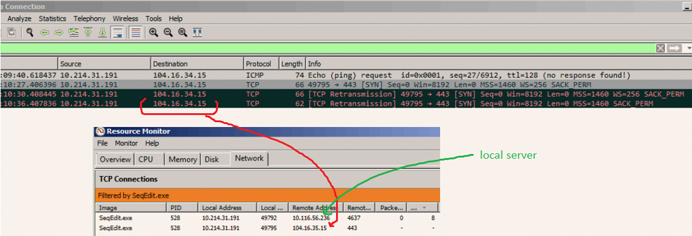

I'm currently struggling with a very similar problem. NILM 4.1, Windows 7, TS 2016 and 2017, no internet access.
From my observations, when SeqEdit is starting it communicates with something at address 104.16.34.15:443 or 104.16.35.15:443. The same address is used by NILM when I open activation window. This is despite the fact that NILM is configured to use a local license server.
In Wireshark I use the ip.dst == 104.16.34.15 filter where I see TCP retransmission. More or less when these attempts end the application starts.
In C:\ProgramData\National Instruments\License Manager\Data\Licensing.log I can find "Failure using web request to check internet connection. Details: WebException: The operation has timed out".
I don't see it in Windows 10 and NILM 21.8.1.
In my opinion, NILM is to blame because it is forcibly trying to communicate with some external server despite the fact that the system is "offline" and is supposed to use locally available licenses.

In my case, the solution was to install the latest version of the NILM supported on Windows 7 (NILM 4.7). This version does not send the mentioned request to the remote server.
