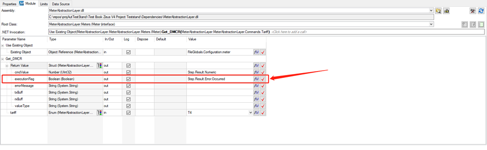

Dears, I'm having trouble to change the value of my boolean before log it on the  ExecutinFlag.png
In my output(ExecutionFlag), I use a different logic, where FALSE means not worked, and TRUE means worked.
So, I need help in matters to or change the teststand to a negative logic or change the variable before post it into the Step.Result.Error.Ocurred .
I have other methods to do this, creating a different statement, and after it send this value to the Error Ocurred, however, all the solutions I have are not convinient, for this reason I decided to post it here.

Dear Cross, I tried to it, however into the post action I cannot see my execution flag anymore. Do you have any advice that allows me so see the ExecutionFlag outside the out context?
Also, I already tried to change the value of the Error Ocurred into the post action using the following expression:
Step.Result.Error.Occurred = !Step.Result.Error.Occurred, it didnt work.

Dear Sps, the first one, I'm trying to force a FAIL using the Step.Result.Error.Occurred .
The only problem is because the logical of my library is TRUE when NOT FAIL and FALSE when FAIL. Exactly the opposite logic of the error.occurred, so I have two options, I can change my library logic, or send the boolean of my library in a inverted logic.
I would like to use the second option, but I'm not able to do it right now.

You can do it using a local variable to support a post-expression execution. If you write directly in Step.Result.Error.Occurred it is going to trigger the default behavior of TestStand.
Put the output of the boolean value that represent the runtime error in a local variable (or any other variable you want to use as a support). In my case Locals.support_boolean
In the Post-Expression of this step, put something like this:

Thanks a lot for you reply.
This solution we also had in mine, however, we would like to not do it, once it will take a lots to change it step by step, in this way we would prefer to change our logical status.
We would like to do it not adding post expression.
Is there any way I can do it on the same line of the attribution?
