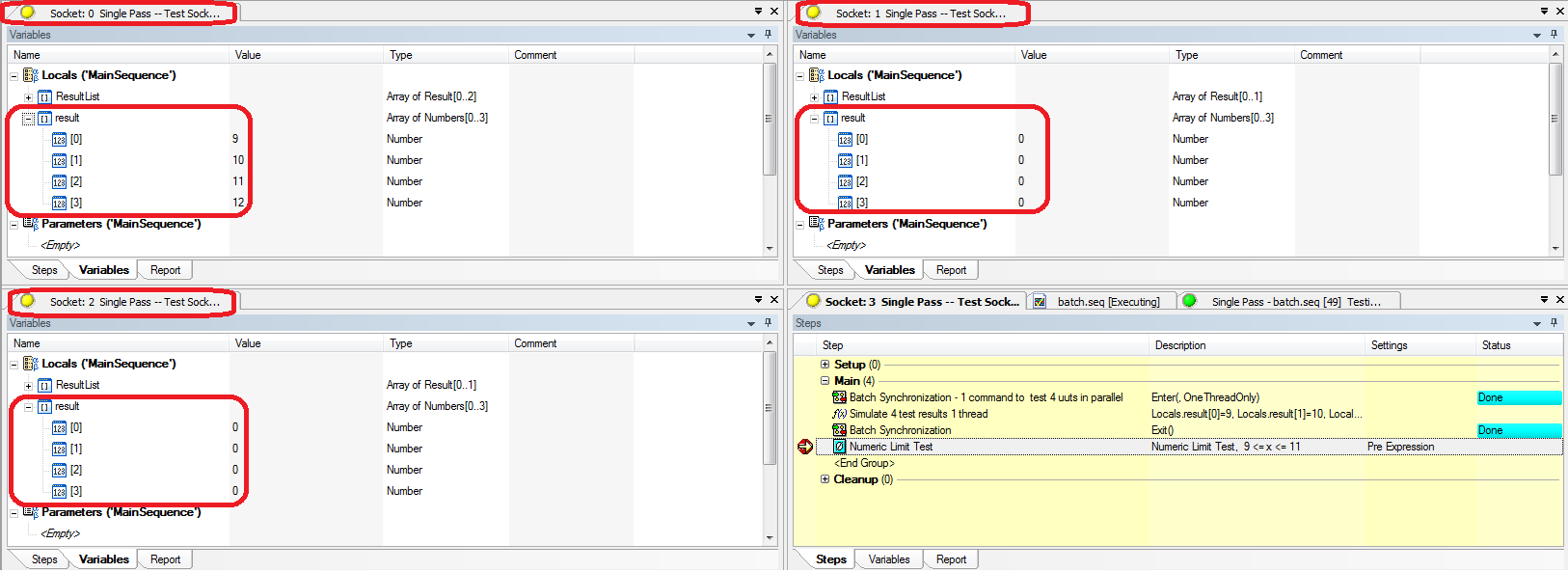

We are almost there.
I understood that I can use the "RunState.TestSockets.MyIndex" to index my results.
What I do not realize is how to make available a value from test socket 0 to test socket 1 - 3.
Please see the picture and the file attached
Batch
PS: Thank you very much for your time
Message 15 of 24
(4,126 Views)
Using Notification or Queue I am able to pass data between test sockets.
Batch with notification
Message 16 of 24

I need to share the results to make tests like "Numeric Limit Test" and save the value to a database associated with the respective test socket (UUT serial number)
Each test will use only the corresponding UUT value.

In the step "Simulate 4 test results 1 thread" I use "One Thread Only"
This thread comunicate with one hardware and gets the results for 4 UUTs.
The results are stored in the Locals.result array.
If I do not pass this data to the others test sockets how can I associate the result and the corresponding UUT serial number since all data are in the test socket 0?
