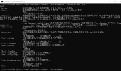

I'm trying to deactivate/activate NI licenses from the Windows terminal, so I'm trying to use NiLicensingCMD. However, I can't find any documentation of how to use it.
Where is the documentation? How do I list the possible SW family names that I can use with the /activate argument? How does the /deactivate argument work (it is unlisted in the /help)?

    You have at least 2 methods to view the operation help for the SW activation
Method 1:
    From the command line, change directory to your NI License Manager software directory, and then run the following command:
NILicensingCmd.exe /help
    You can see all the parameters and instructions

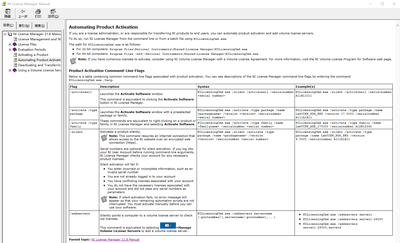

     Method 2:
    In your NI License Manager software directory, open nilm.chm, and you can see the specific operation description

I know about /help, however it doesn't give information for what accepted values can be used for the SW family argument for activating a license. Also, /help doesn't list the /deactivate option. If you try "NILicensingCmd.exe /deactivate", it recognizes it as a valid option, but it says that it's missing arguments and I can't find documentation that says what arguments /deactivate requires.
