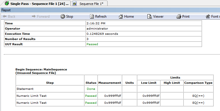

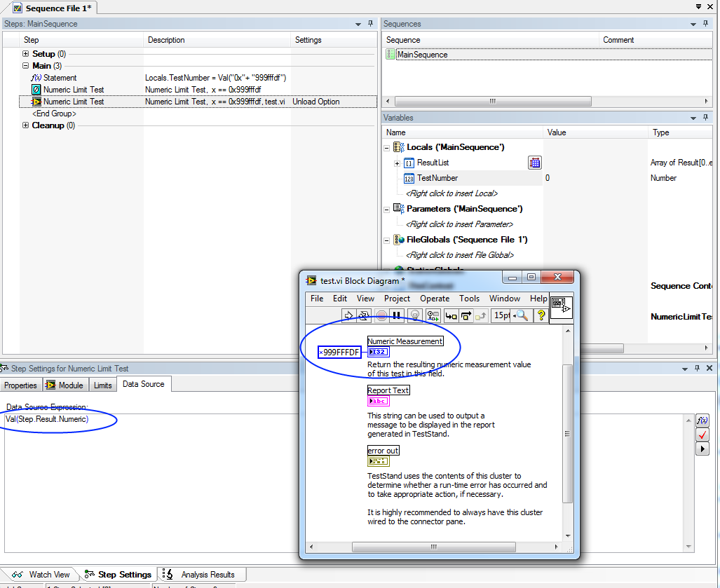

After looking into this some more, I determined how to configure TestStand to successfully compare the hexadecimal values.
Under the Data Source Expression of the Numeric Limit Test, you must wrap the returned value in the Val() function as so:
Val(Step.Result.Numeric)
This is necessary if you are returning an integer from LabVIEW.
