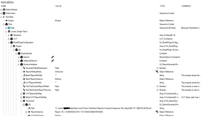

For debugging, the best way would be to set a breakpoint in the beginning of your MainSequence, and then opening up the variable tree and going down the path I described.
It should look like this:
Stefan

I can confirm that in 2019, the variable seems to be empty.
Couldn't find the time today to check why that is.
Re-Edit: in TestStand 2019, the report file path is calculated in the UUT Done part of the Report Plugin, so it is undefined during client sequence execution 😯
Message 9 of 10
(3,715 Views)
This is interesting because after double checking, the report path variable is filled in the UUT Start part of the report plugin in TestStand 2020 (so prior to the MainSequence call).
