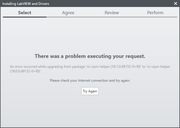

Okay fine, I already have NI Package Manager installed so I run that, select LabVIEW and Drivers, select only "LabVIEW" and let it do its thing...until there is this error.
This is on a Windows 10 x64 machine that is connected to the internet.  I'm now downloading the Spring 2019 package instead from home and will try bringing that into work tomorrow to try again.  Any suggestions?  Is there known issues with the download package?  It could be weird IT things here I really just have no idea.  Attached is the errorlog from the last attempt using NIPM.

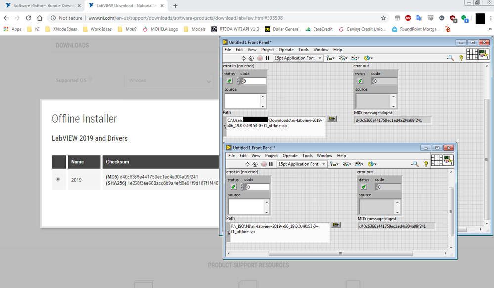

Attached is an image showing the expected MD5 of the download, along with the MD5 of the downloaded file, and the MD5 of the file after copying it to the external USB drive and all are good.
I unplugged the USB drive, plugged it into the Windows 10 machine I want to install it on, I right click the ISO and select Mount (built into Windows 10), and then from there I run the installer as Admin.  My external drive has the ability to mount ISOs via hardware emulation and I tried that too but it resulted in the same error.  I found a post saying Windows 10 might not like mounting if the file name has multiple periods in the name so I renamed it something simple.  I also tried running the installer with the ethernet cable unplugged forcing no connection to ni.com.  After restarting the installer multiple times, and running the setup within the ISO without mounting, I was eventually able to finish the installation process.  This was after running the same setup within the same ISO that had the proper MD5.  I'm not sure what was going on but I suspect disconnecting the ethernet solved it.

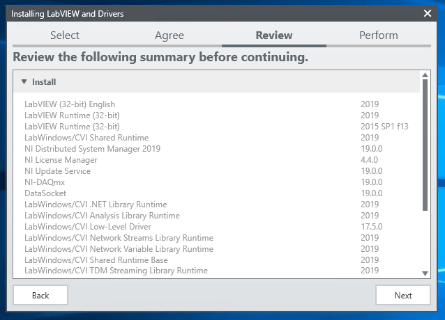

Regarding bitness.  I went to this page yesterday:
http://www.ni.com/en-us/support/downloads/software-products/download.labview.html
Clicked Download, ran the setup, selected "LabVIEW" and in the review section I saw this:
Note that this was after I was able to successfully install using the offline install which is why some things are already installed.
I redownloaded the setup this morning and the 32 bit one is now shown in the review.
