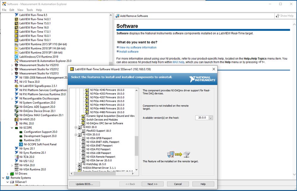

I have a chassis with LVRT 2018, I'd like to update the drivers (specifically NI-Scope and NI-Sync) to version 20.0
I downloaded them via NIPM, when I check in MAX they appear in my local software tree just fine.
But when I try to install to my remote RT controller it can't find the driver
NI-VISA and DAQmx installed fine
This is confusing, anyone know what's going on here?

In the packages tab there are a load of extra things to install for NI-SCOPE and NI-Sync specific to pharlap and ETS real time targets.
