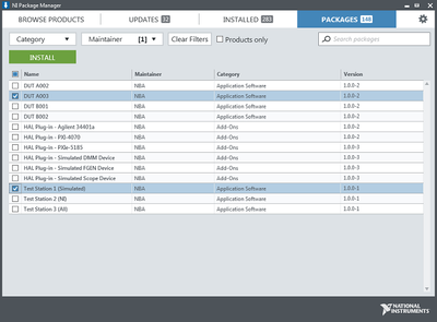

  • Use NIPM for distributing and updating deployed applications
    (e.g. componentized applications, application EXE, PPLs, application plug-ins, NI drivers and software, LabVIEW Run-Time Engine, …).
Note: You can use NIPM to distribute LabVIEW 20xx source/development code by creating a Source Distribution build specification and creating a Package build specification that includes the Source Distribution buildspec.  Then you can configure the Package buildspec to install the Source Distribution to a specific location (e.g. <Program Files>\...\LabVIEW 2017\user.lib\acme).
