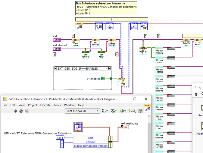

(2) Your Instruction Framework is the key to customize FPGA Extensions like VST.  I ported my IP with the Extension with a specific UID, and found an error occurs on host-side looking up single address space.  Then, I realized that user IP is joined to a part of "collection" of multiple address spaces on Extension layer.  I did not find any tutorial about this use-case neither on your tutorial nor VST documentation.
Space Collection on FPGA ExtensionSpace Collection on FPGA Extension
Once I noticed that UID can be set as layer by "collection", I successfully reached to my IP by chaining the "parent context" like below.  (2411: Extension Collection Address >> 32769: My Address)
