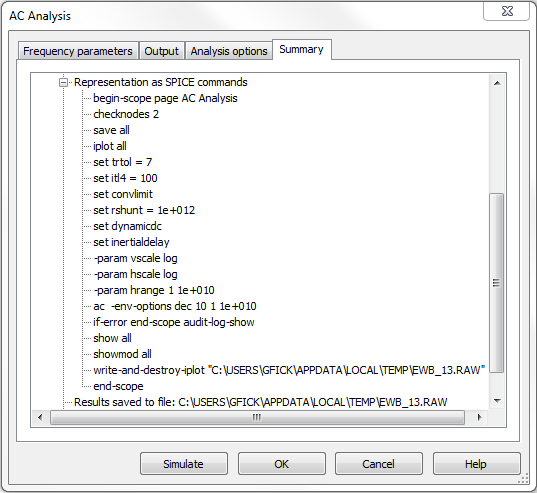

Multisim uses its own control language (derived from NUTMEG). It is similar but not identical to SPICE 3f5. If you use the XSPICE command line interface or simulate using XSPICE commands through the COM API, you will need to use this command language. Unfortunately, it is undocumented. You can, however, use Multisim to determine the commands and syntax to send.
Each of the analyses (Simulate > Analyses) shows the commands that are sent to the simulator. You can combine these with the NUTMEG documentation to perform command line simulations. It will require some trial and error, but I have successfully in the past used this information to perform simulations.
